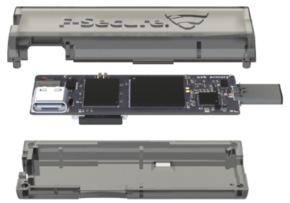

USB armory
The USB armory is an open source hardware design, implementing a flash drive sized computer.

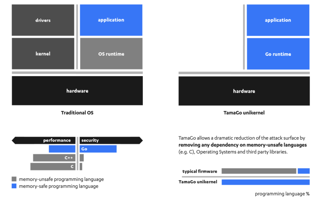

TamaGo
In addition to native support for standard operating environments, such as Linux distributions, the USB armory is directly supported by TamaGo, an WithSecure Foundry developed framework that provides execution of unencumbered Go applications on bare metal ARM® System-on-Chip (SoC) processors.

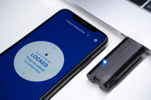

Amory Drive
The USB armory provides secure execution of cryptographic operations and data storage.
The user can unlock the USB armory over Bluetooth, authorizing only need-to-know contents, to ensure safe operation even on untrusted laptops.

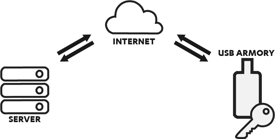

When hosting facilities cannot be trusted, the USB armory, plugged on a server, complements its potentially unsafe environment with self-contained, tamper proof, HSM services.
Remote peers can authenticate the USB armory and use it, while the server remains an unprivileged party.
The server itself can also use the USB armory HSM services for CA/PKI or any other cryptographic purpose, without having access to protected keys.

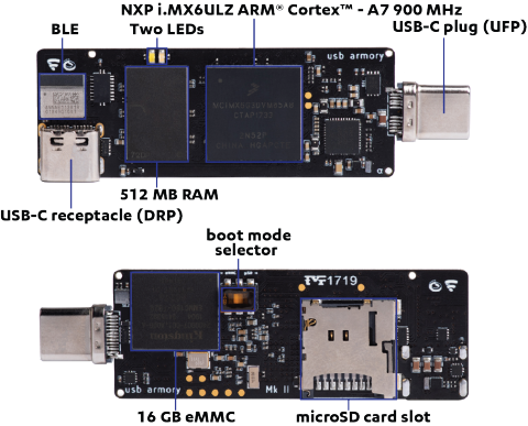

Model | Configuration |
UA-MKII-ULZ-512M | USB armory Mk II • i.MX6ULZ 900 MHz • 512 MB RAM • enclosure |
UA-MKII-DA | Debug accessory for the USB armory Mk II |
